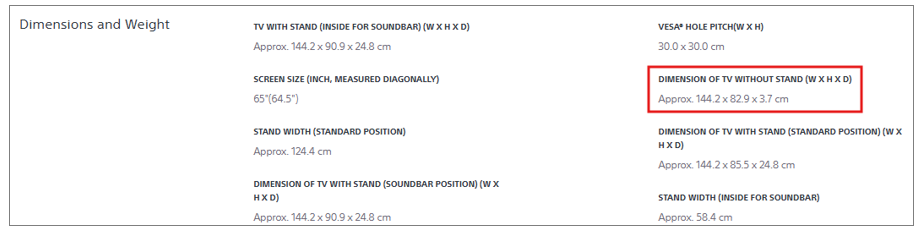

    Minimum viewing distance 4k/8K model - 1.5 times vertical screen size
    Note: To know your TV's vertical height, you can refer to the specifications of your TV, under Dimensions and Weight.
