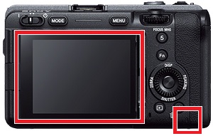

  4. A black screen is displayed when the system software update starts, and the access lamp flashes. The access lamp flashes 1 time3 times5 times depending on the progress of the update. The update will take approximately 6 minutes to complete.
    Location of the Access lamp: It's on the bottom right of Rear side.
