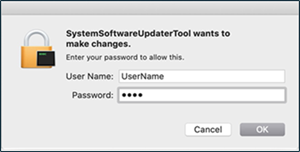

  4. A message will prompt you to allow the application to make changes. Enter the password for the administrator account, then click OK.
    Enter it in the Password field in the center of the screen, and press the [OK] button at the bottom right of the screen.
