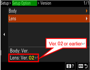

Check the System Software Version of Your Lens
Follow the instructions below to check the lens system software version. If the system software version is Ver. 02 or earlier, the update is required.
    1. On the camera, select Menu → Setup → Setup Option → Version.
    2. The lens system software version is displayed.

    2. Select Menu → Setup → Setup Option → Version.

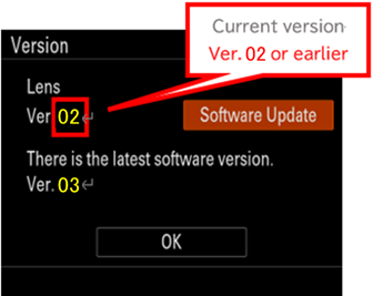

    3. Select Lens.
    4. Confirm that the current software version is Ver.02 or earlier, and then click Software Update next to the version number.

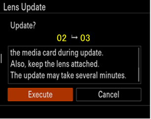

    5. Select Execute on the system software update confirmation screen. The software version update will start.
      Notes:
      • Do not remove the battery or memory card during the update.
      • After confirming the details, you may click Execute.
      • Please scroll down the screen as necessary to view the full text.
    6. The update process starts and the progress bar is displayed on the camera (approximately 60 seconds).
    7. The update process is finished when the “Lens update complete.” message is displayed on the camera.
