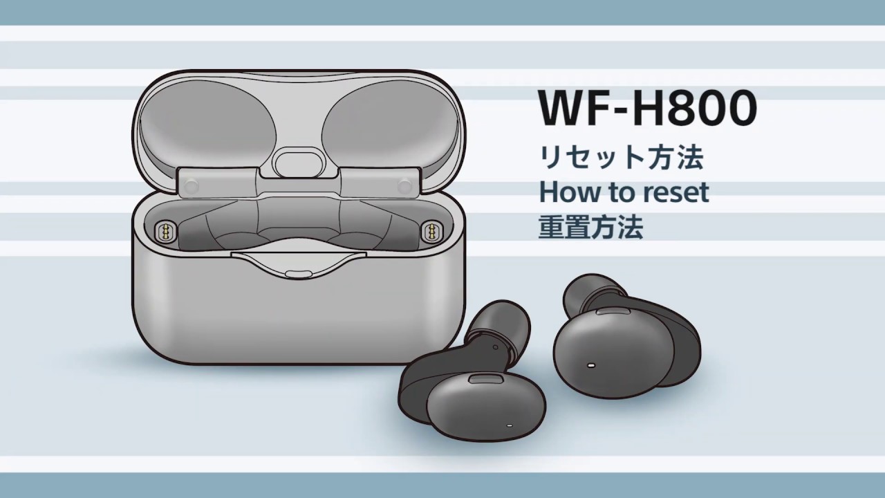

      Check to see if the issue is resolved after resetting the headphones.
      • For how to reset the headphones, visit the Help Guide or view the video on how to reset the headphones.
      If the issue is resolved after resetting the headphones, the issue was caused by a temporary malfunction of the headphones. Wait until the headphones are fully charged.
      If the issue is not resolved, go to step 6.
      WF-H800
