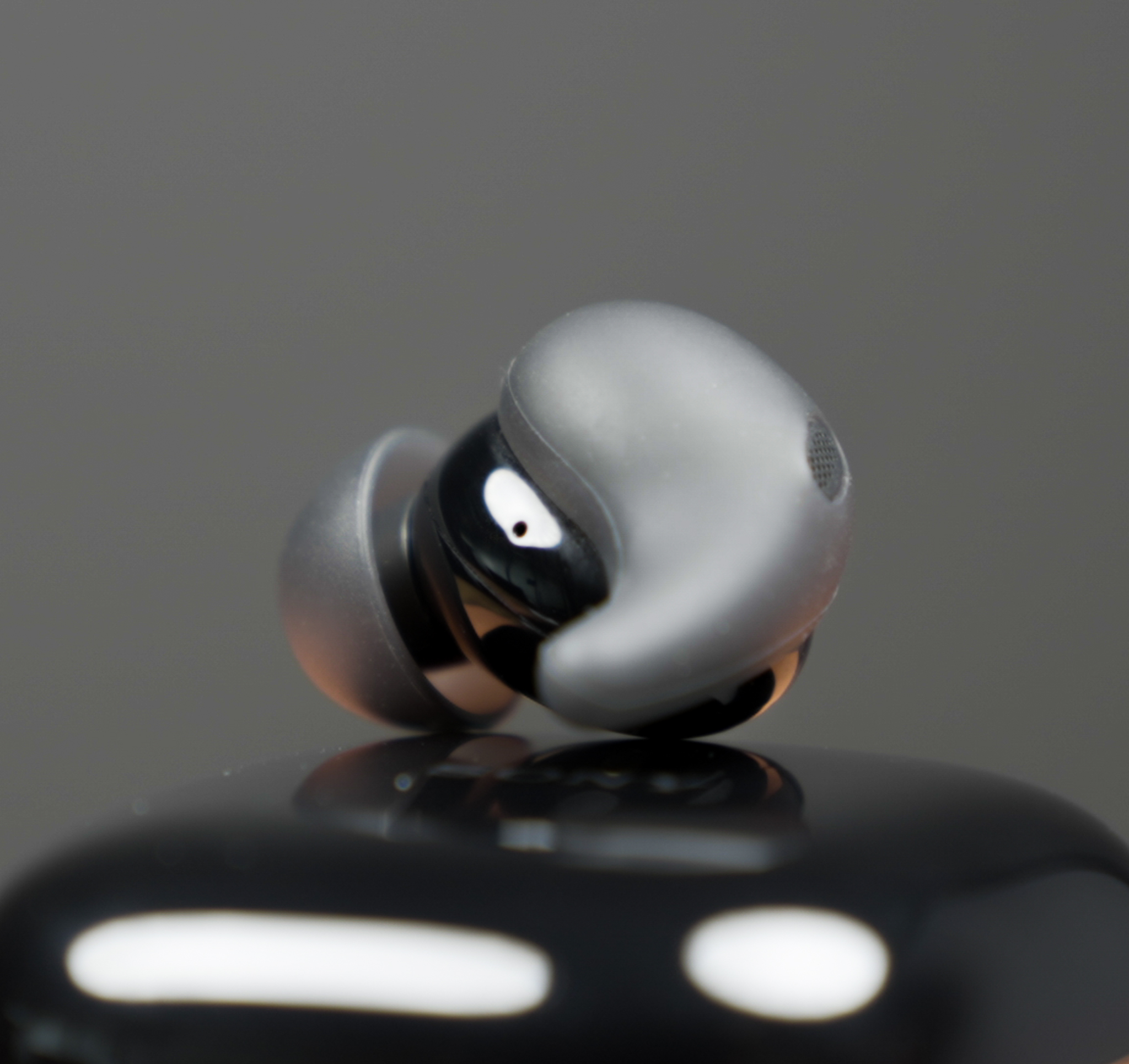

    2. Clean the headphones
    Clean the earbud surface
    Dust and dirt on the surface of the earbuds can be wiped off with 99% water-based wipes. Do not use solvents such as thinner, benzene, or alcohol as they may damage the finish on the surface of the earbuds or cause other damages.
    If water drops get on the earbuds, wipe them off with a dry, soft cloth. In cold regions, water drops may freeze if left on the earbuds.
    If foreign matter, sweat, or moisture is left on the charging port, the charging function may be affected or not be possible at all. Be sure to regularly clean the contact points of the charging case and earbuds using a cotton swab or dry, soft cloth.
    Hint: If charging does not start, wiping off the charging ports may resolve the issue.
    Note: Do not use an air duster to remove dust as it may get into the microphone or sound output holes, causing the earbuds to malfunction.
    Clean the charging ports
    • Contact points on the charging case and the earbuds:
      Image showing the charging ports located in the center of the charging case as A
      Image showing the charging ports located on the top of the back of the headphones' housing parts
    • Clean the contact points on the earbuds using a cotton swab or dry, soft cloth.
      image cleaning the charging ports inside the headphones
      image cleaning the charging ports on the back of  the housing ports
    Clean the air holes
    If foreign substances (such as earwax) build up in the air holes, no sound may come out, the volume may seem lower than usual, or noise may occur. Make sure clean the air holes using a cotton swab or dry, soft cloth.
    Hint: If dirt has built up, gently remove it with a thin, soft toothbrush. Make sure not to insert the toothbrush too deeply to avoid damaging internal components.
    Image showing the air hole located on the lower side of the fitting supporter as A
    Clean the IR sensors
    If the IR sensor is dirty, it may not detect the wearing conditions and the earbuds may not work properly. Wipe off any dirt on the IR sensor with a dry, soft cloth.
    Image showing the IR sensors located just above the earbud tips as A
    Clean the sound output holes
    With a cloth dampened with water and wrung tightly, clean the sound output holes to remove dirt, earwax, or anything that may accumulated, being careful not to accidentally push dirt or debris into the earbuds.
    Image showing the sound output hole that can be seen when the earbud tip is removed as A
    Drain the sound output holes
    If water remains in the sound output holes, the sound from the earbuds may get lower or not come out at all. If this is the case, position the sound output holes facing downward, and shake about 20 times to get the water out.
    Drain the microphone holes
    Leaving water in the microphone holes may cause corrosion. If this is the case, position the microphone holes facing downward, and shake about 20 times to get the water out.
    Image showing the microphone located in the hole on the fitting supporter as A
    Dry the earbuds
    Once cleaning is complete, leave the earbuds to dry thoroughly at room temperature.
    Note when drying the earbuds: If the IR sensor is touching the table, the sensor may assume the earbuds are being worn and the rechargeable battery may continue to be consumed. Place the earbuds with the IR sensor facing sideways or upward.
