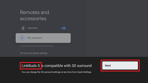

    Just by pairing the wireless neckband speaker or Sony brand headphones to your TV, 3D Surround is added to the quick settings, and you can enjoy standard 3D surround without any special settings. To enjoy a more immersive 3D surround, check the following.

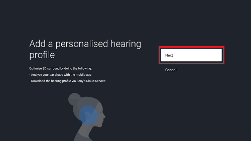

    1. On the screen displayed after the pairing, select Next. You will see a settings screen to enjoy a more immersive 3D surround.
      Note: The headphone model name or device name is displayed.

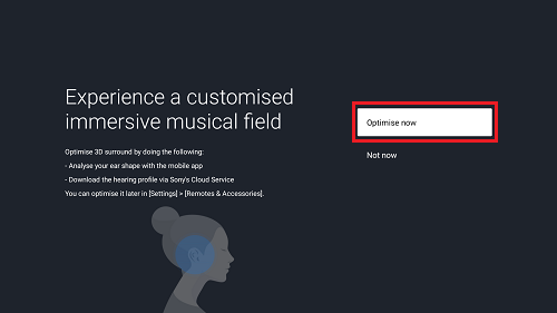

    2. Select Optimise now to continue setting up a more immersive 3D surround.
      Note: You can also adjust this setting later. In that case, select Not now. If you would like to set it later, please refer to the To set 3D surround settings later.

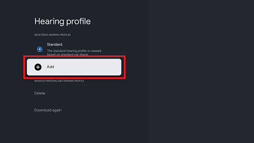

    To set the immersive 3D surround settings later, or to make additional settings with another account:
    A more immersive 3D surround setting can be made later, or additional settings can be made in another account. Check the following for the procedure.
    1. On the TV remote control, press the Quick Settings button.
    2. Select Settings.
    3. Select Display & SoundAudio outputBluetooth device settings → 3D surround device settings → Hearing profile.
    4. Select Add.
    5. Select Next and follow the onscreen instructions.
