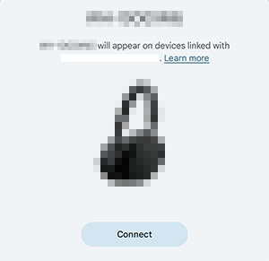

    Hint: What is Google Fast Pair?
    When you bring an Android smartphone close to the headphones while they are in pairing mode, a notification appears on the smartphone. Tap Connect to pair the devices.
    Google Fast Pair notification screen. The [Connect] button is displayed at the bottom of the screen.
